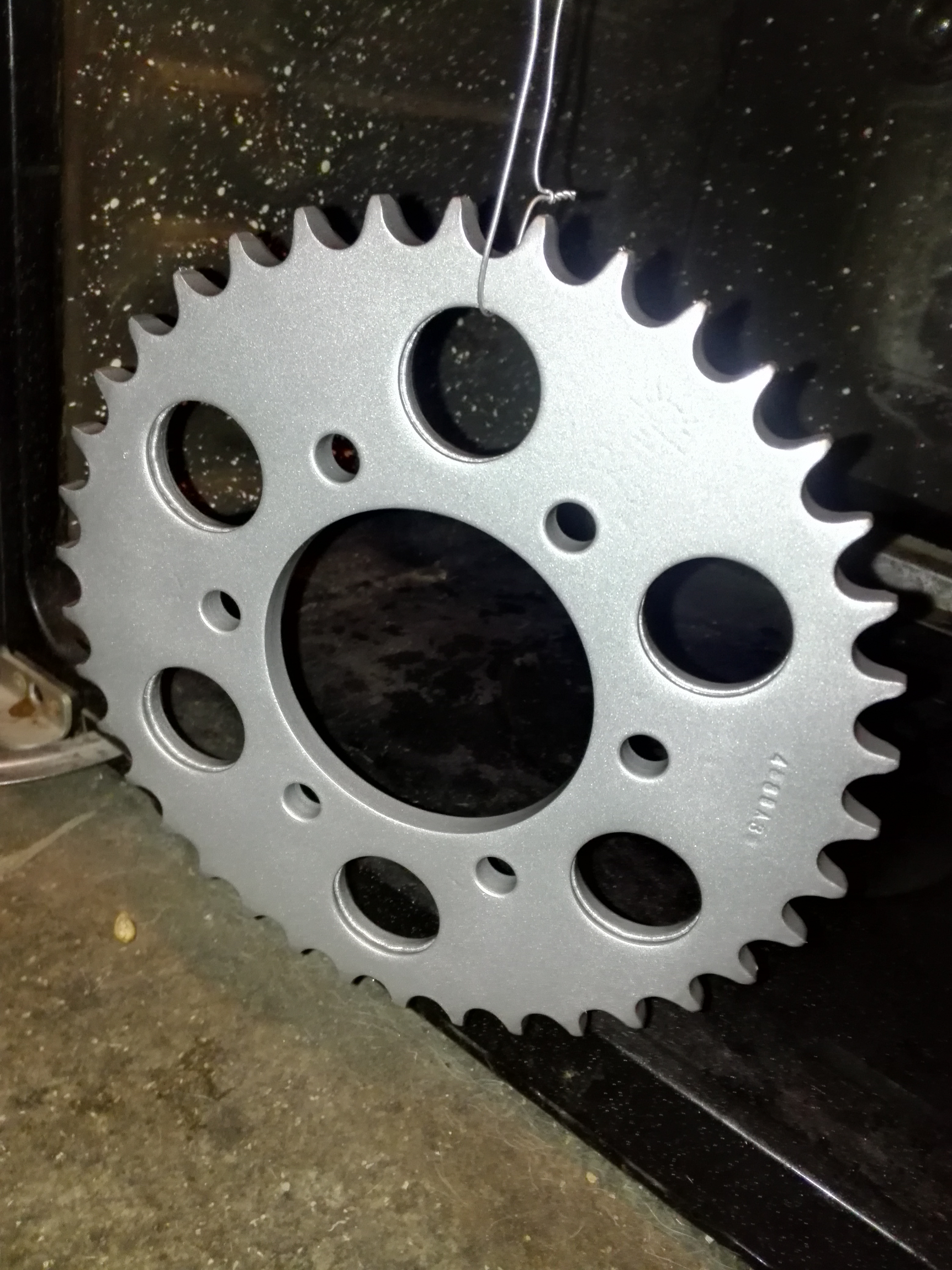

Next up is the sprocket and carrier.
The sprocket looked like it would still be ok but would need a lot of cleaning. There was a lot of rock-hard chain lube on everything. This stuff had to be chipped off with a blade.
Its really thick
Lots of chipping later and its ready for wire brushing
I started the wire brushing on the teeth to check the condition. Hardly worn at all. This sprocket should still be good.
After a lot of wire brushing its all clean. I had planned to plate it but it wont fit in the tank so I will paint it instead.
All painted, fresh from the oven and looking spiffy 🙂
