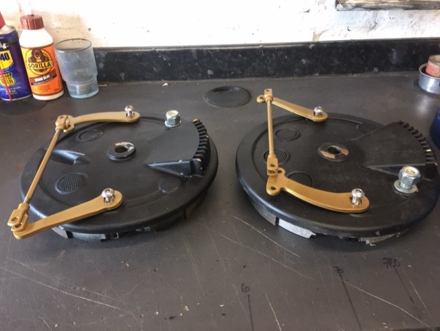

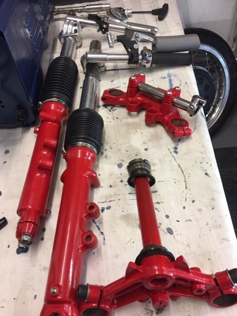

We had some issues getting the new taper bearing cups to seat properly, resolved after my pal made a puller up.The front end has gone back on now and I’m just in the process of re-fitting all the linkages and controls to the Grimeca 4LS brake plates, then they can go on.

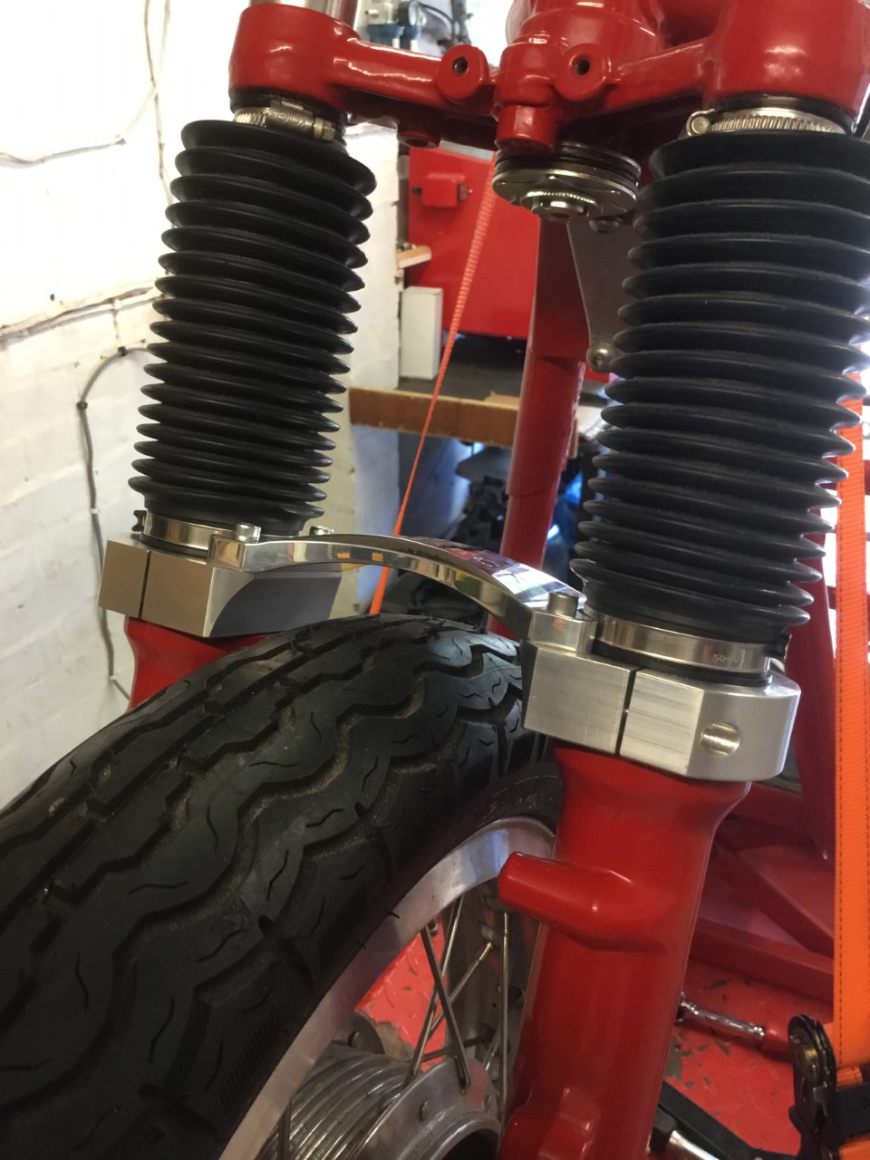

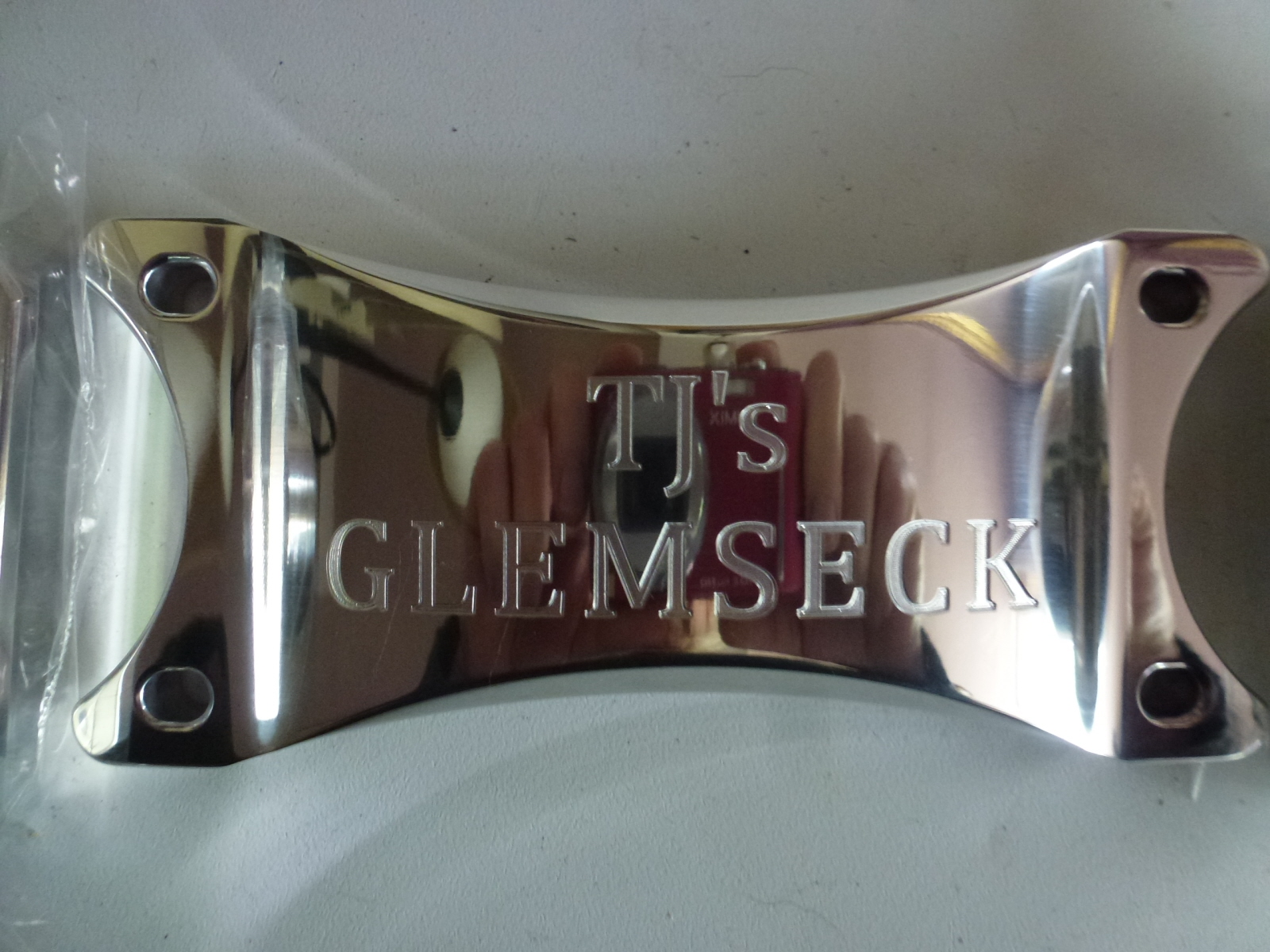

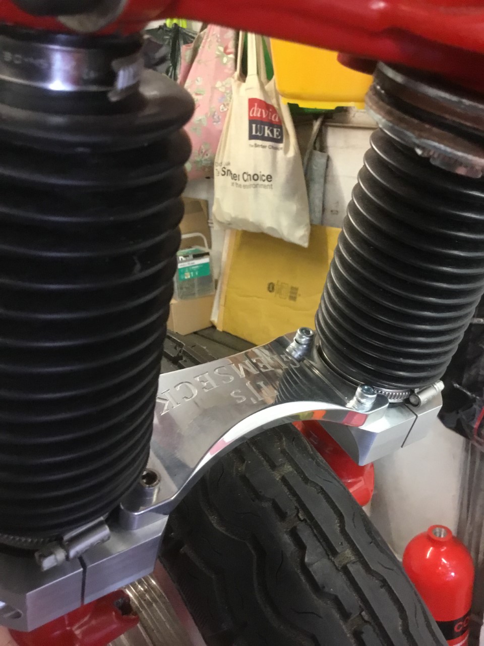

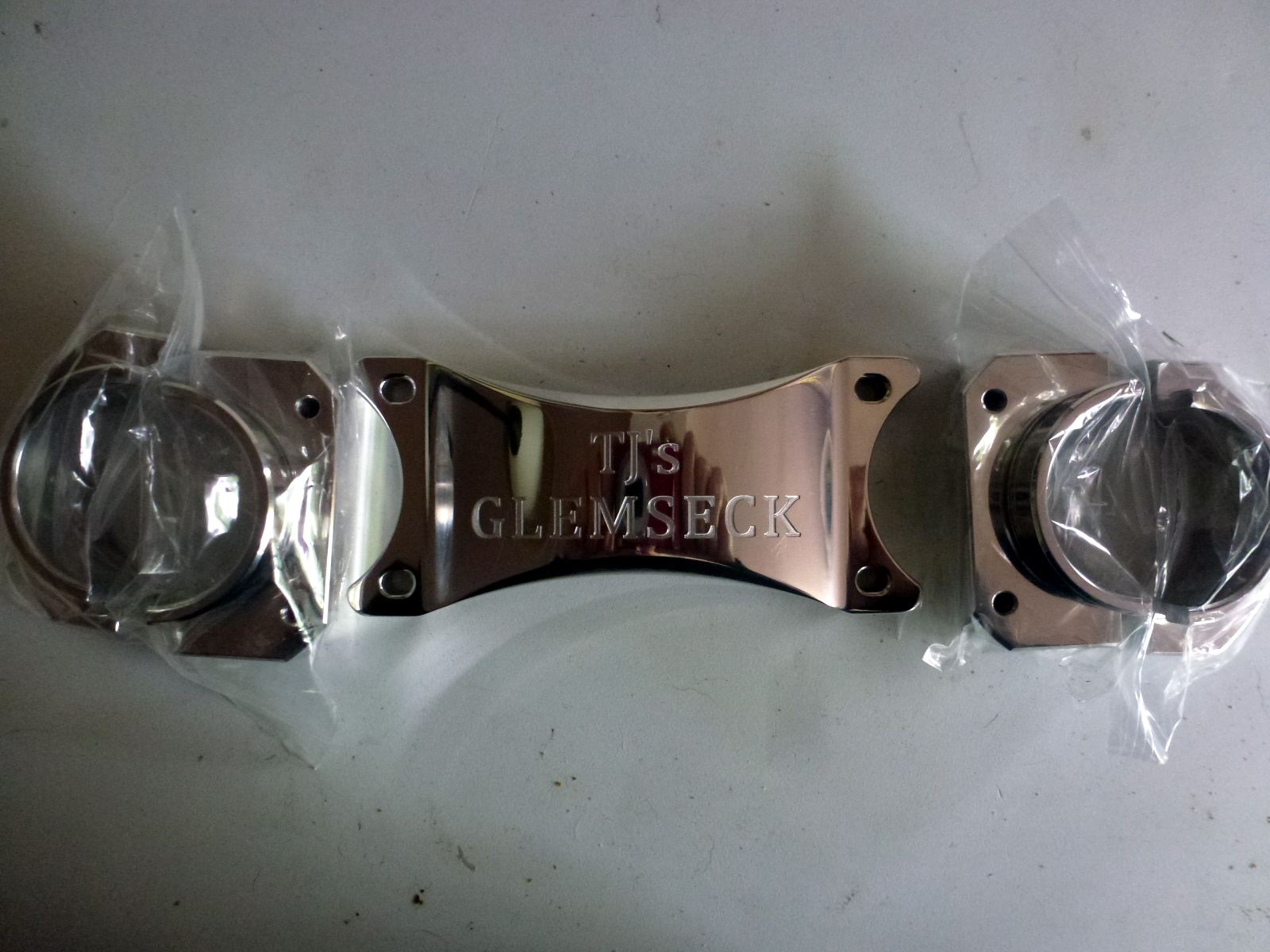

I eventually got a fork brace ! The Tarrozi one I ordered didn’t fit and eventually I found a company to make me a bespoke item – for the same price as the Tarrozi !! It’s perfect, and they even threw in some personalised engraving for free – Fastec Racing are the guys.

Finally found out the weirdness with my forks ! They were always suspected as not being stock items…………………. you guys told me !!!

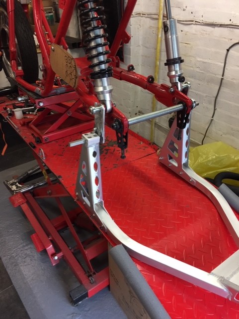

Found that out when I came to fit my new fork brace !! My fork legs are 60mm dia at the top and not the standard 55mm ! My local machinist guy made me new 60mm clamps so at least I managed to save the newly engraved fork bridge ! He also made the bobbins for the new paddock stand. My machinist is going to give me a price for 10 off fork braces to fit the stock 55mm fork tops.

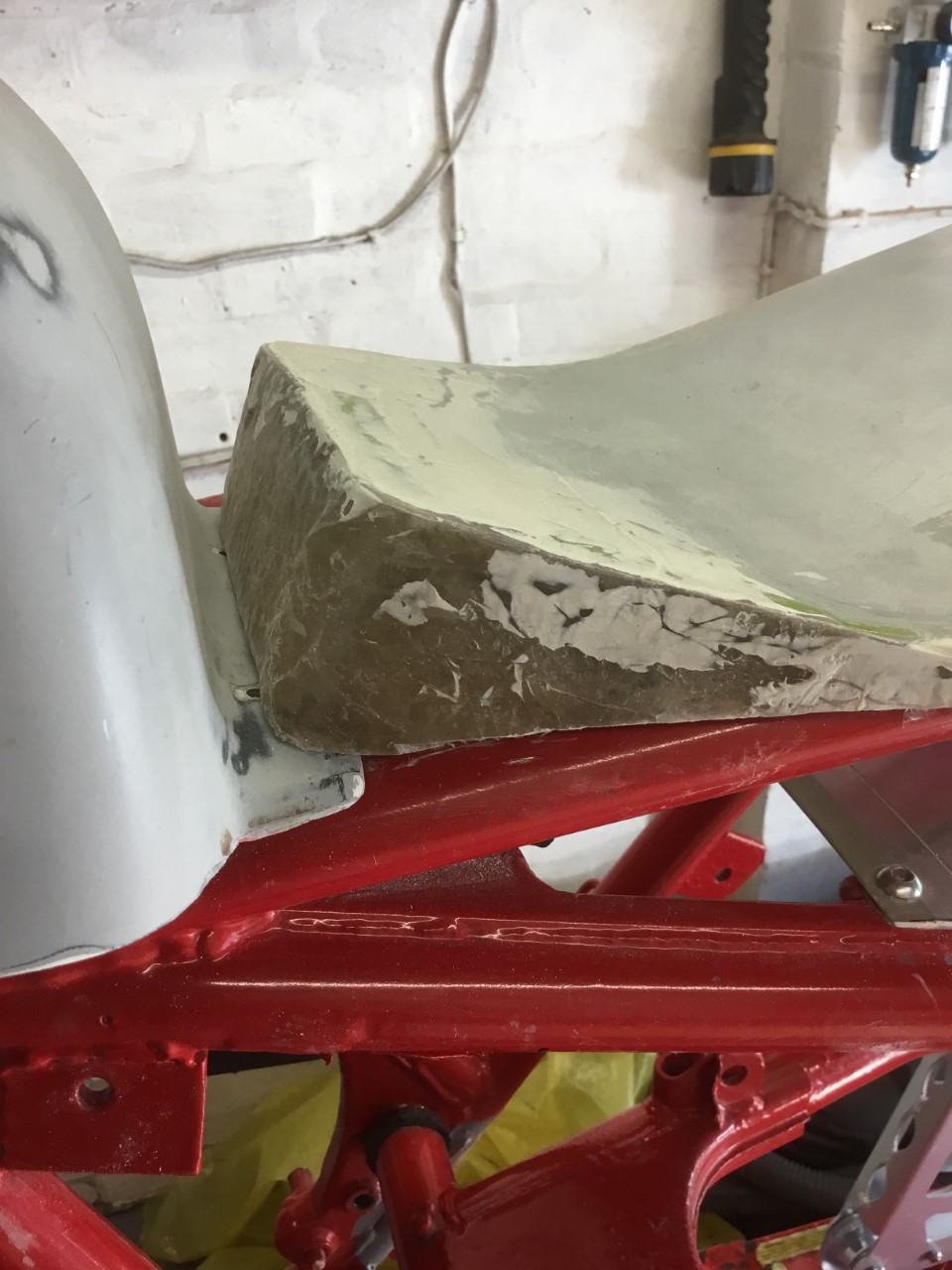

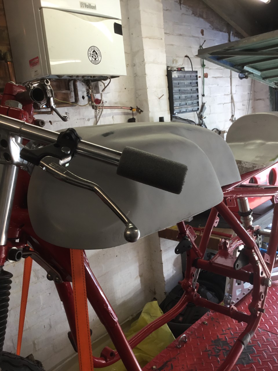

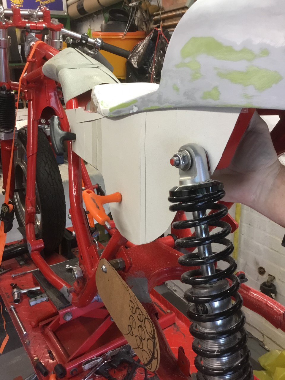

We’ve got the seat brackets made and mounted and ditto the “tank”. That has allowed us to site the position for the footrests, bars, etc. I’m also making up “bikini” side panels that will incorporate the race plate oval.
The belly pan fuel cell is almost completed, and we’ve mocked up the fuel delivery system – filler in back of seat hump.

beachcomberParticipantAnother good week of progress. The seat pattern making is now completed and all the fixings are glassed in. The side panel shape has been finalised and is ready to be transferred into 1.2mm or 1.5mm alloy. The top edge will be attached to the seat and that in turn will give the top edge a gentle curve …. nothing worse than a flat ally panel !
The “tank” fixings are now glassed in, and it’s been trial fitted so we can finalise the position of the footrest / bars / seat relationship.
