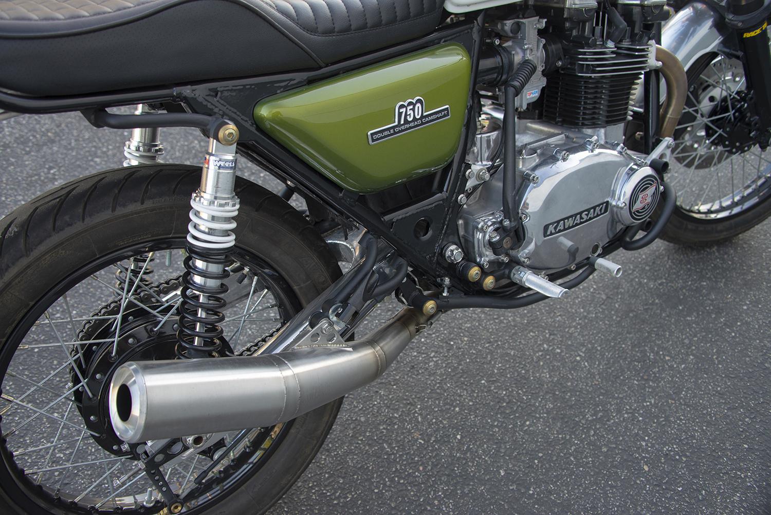

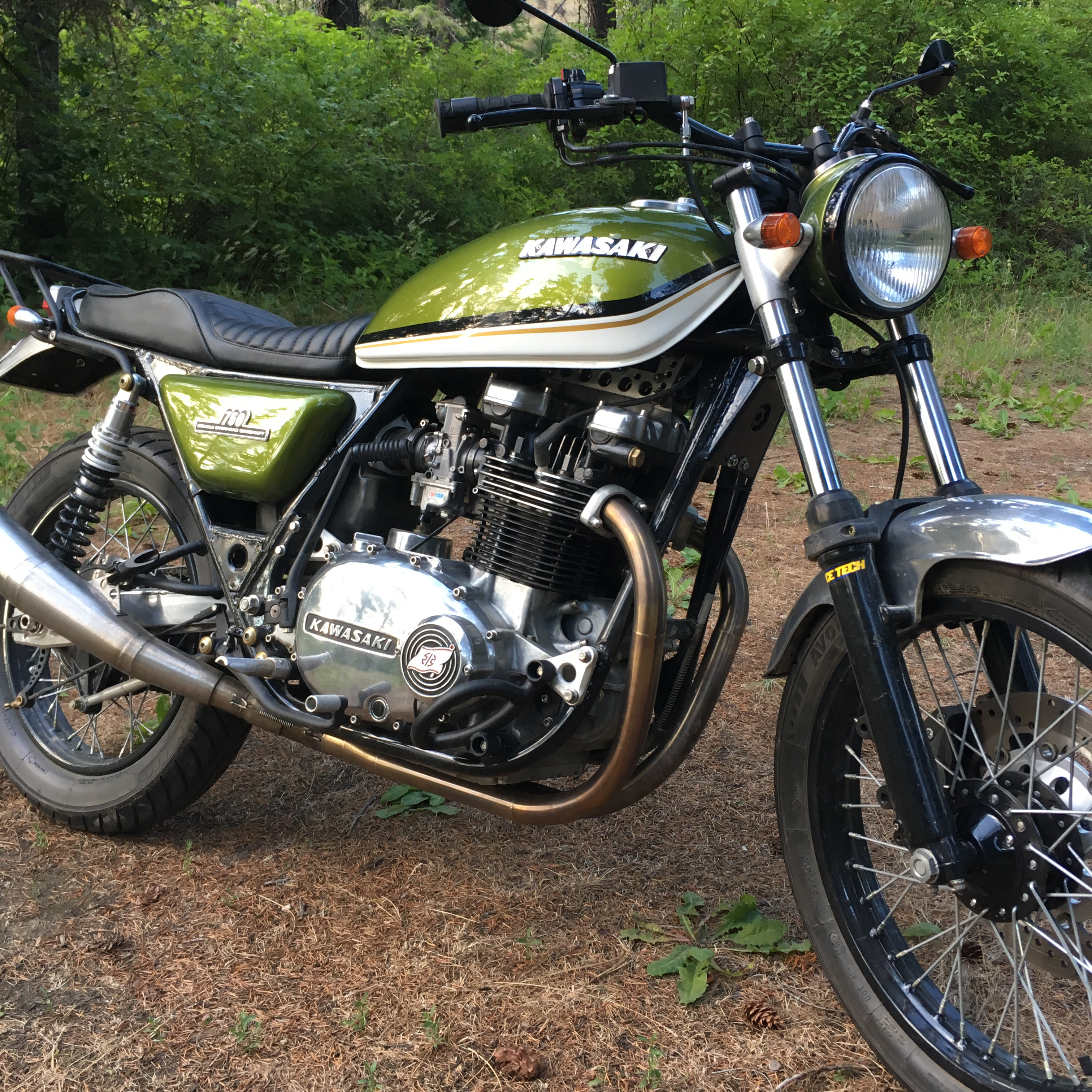

I thought I would share some pics of my ongoing twin project. Its got a bunch of one-off parts, most of which I made myself. In its most recent iteration, the engine was setup with custom cams, port and polish, decked head, custom high compression Venoilia pistons (78mm), breathing through RS-34 carbs and a custom stainless exhaust which I made myself. I had it out for a road trip this summer and it performed great, not too bad with 62 hp to the wheel with stock displacement. However something was amiss as it starting blowing smoke out of the breather like a choo choo train. I’m blaming the cheap aftermarket one piece oil rings. I thought the bike was good before, but like a proper gearhead I want more power so I’m in the process of doing a big bore conversion. Here’s some gratuitous pics!

KaptainkwakKeymasterWelcome back Doctorot
That’s a very smart restoration and what a nice colour.
The pics are great. Thank you for sharing.
7th January 2020 at 7:21 pm #25389
coleighfParticipantThat looks fantastic Doctorot. A lot of “specials” look like codges, but that one is more like a factory job. Very smart and looks up to date, not forty or so years old.

ParticipantYes i agree, it’s a great build no doubt. A lot of attention to details and it shows. I wonder though, where did you obtain the decal on the r/h casing showing the old emblem of Kawasaki.

-Gizburn, its a custom ignition cover I designed and cast myself.if you want to see my complete documented build you can find it here> https://kzrider.com/forum/11-projects/598240-saving-a-1980-750-twin?start=0
