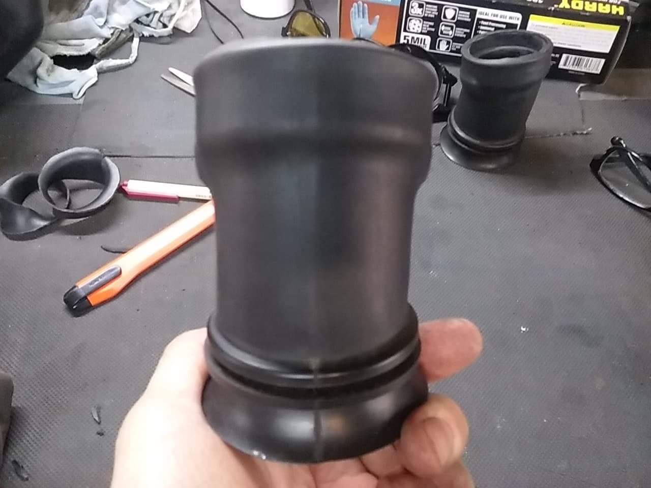

Pic 1 shows the carb boot after Black RTV sealant was applied and dry.

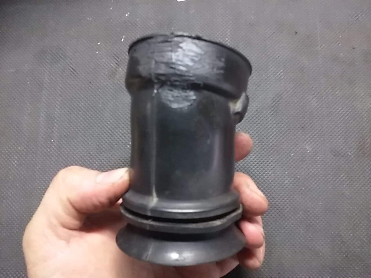

Pic 2 shows heat shrink tubing after it was shrunk. You see the excess.

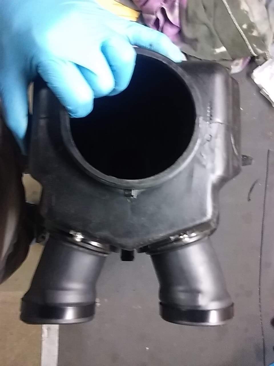

Pic 3 shows the part after the excess heat shrink tubing was trimmed.

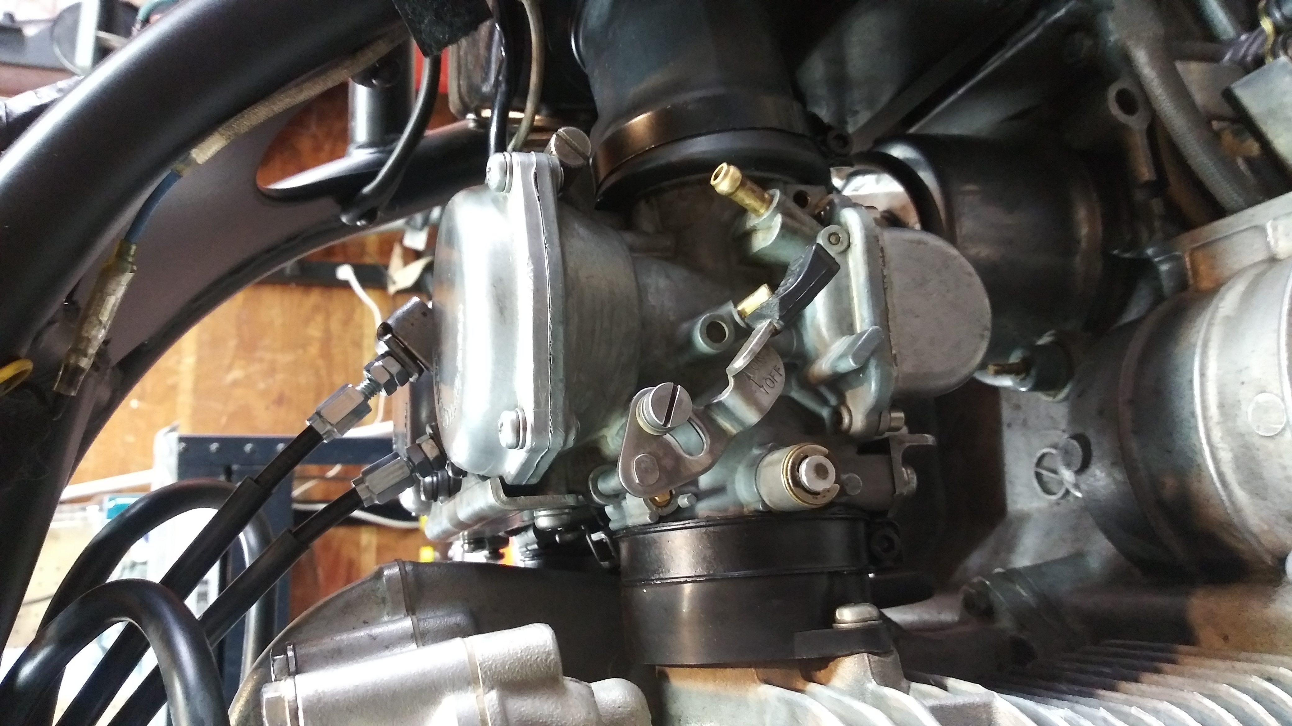

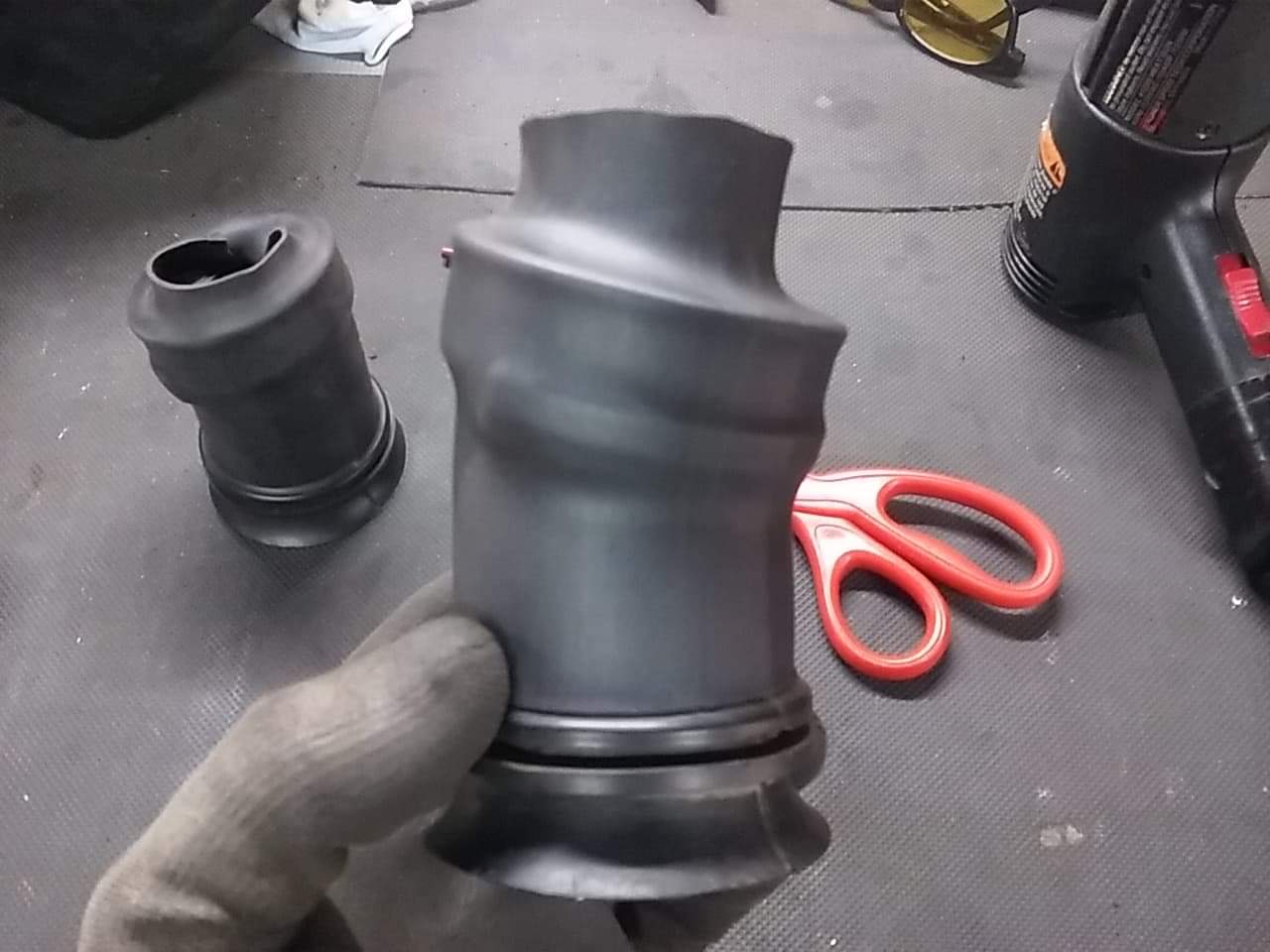

Pics 4 and 5 show the part installed.
